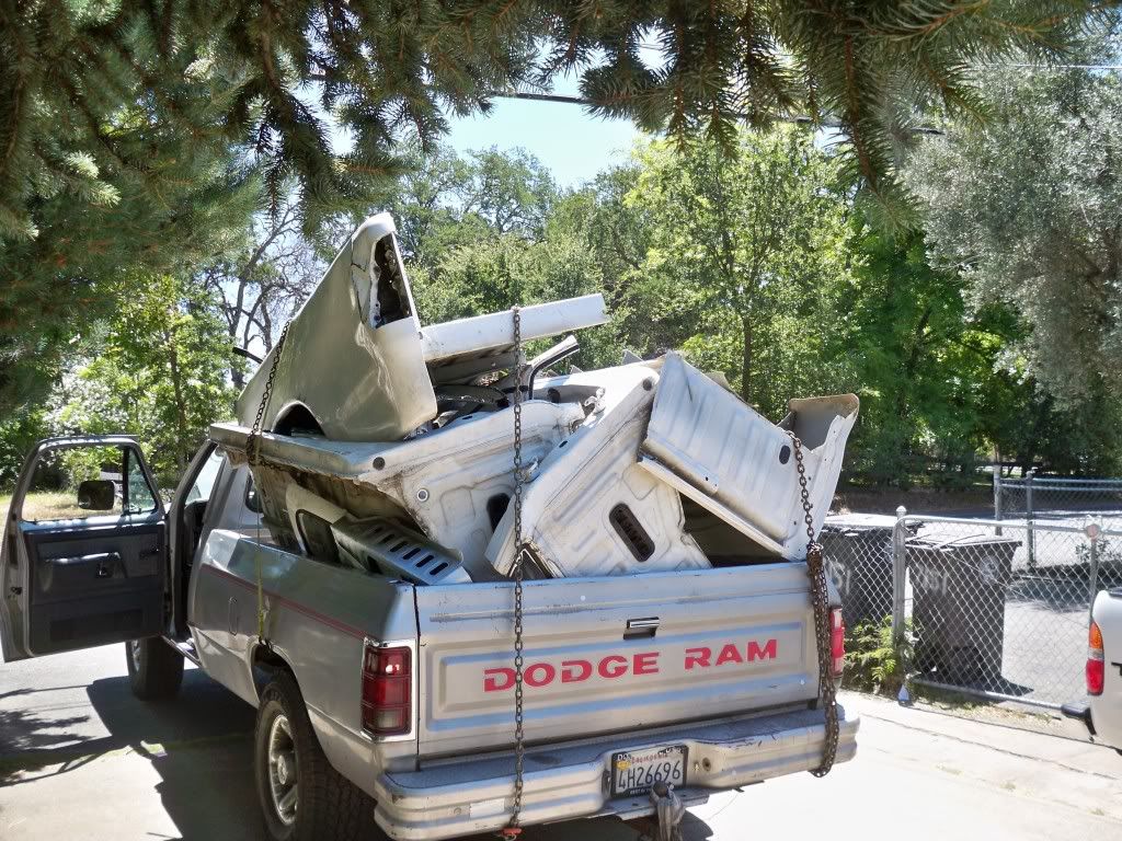

finally got the tundra out of the driveway and did some clean up around the yard. (gotta look decent for the HK party)
no more tundra = back to work on the build.
