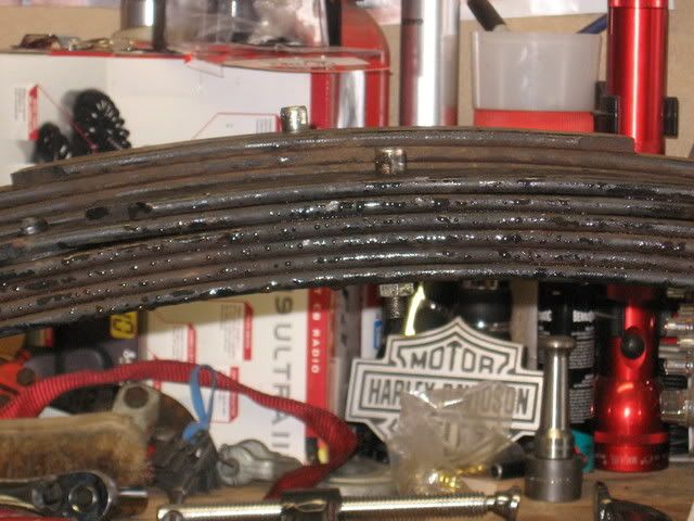

Well I decided to build me some hybrid front sping pack's. I have wanted to try stock Toyota rear main's on top of the 44044 pack but did not have a spare set of 44044's. When I saw that Marty replaced his front spring's I gave him a call. I was hoping that his old spring's were 44044's but they were not. He had Marlin 4" spring's. He gave them to me for a good price, thank you again Marty. O.K. now on to the good part, I had some stock Toyota rear's laying around so I used the main leave and the second one from the top with the military wrap. I removed the top two from the Marlin spring's and put the Toy's in place of them. Once I got them mounted in under the rig I was happy with the end result. I ended up dropping the front of the truck 1" wich I am happy about and moved my front axle forward another 1.5" for a total of 4.5" over stock. My wheel base is now 105.5" I took the truck to a loading dock and twisted it up, there was also a 3' man hole cone there that I pulled up on top off. The spring's seem to be working pretty dam good but we will have to wait and see how they do on the trail.

Here is a pic of the Hybrid spring's against the 44044 for comparison. The front spring iss the 44044 and the back is the hybrid. The front bushing's are lined up in the picture. Although the hybrid sit's higher it actually lowered the truck.
