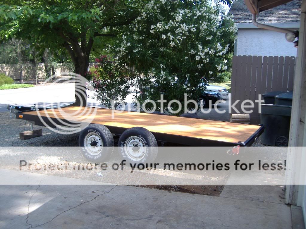

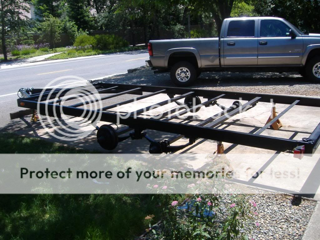

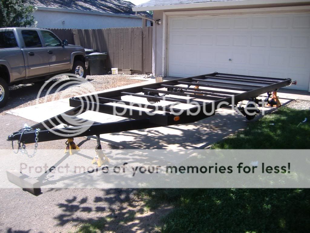

painted wired and ready to go pick up the wood for it {Grin} the taillights on the back are temporary I havent cut the holes for the flush mounted ones yet.... still need to put the wood on, get 8 feet more wire for the trailer brakes since I didnt order enough came about a foot short of going across to the other brake I was a little pissed....build wheel wells and ramps, mount the jack and need to buy a tool box, a harbor freight winch and fairlead on the cheap for the tongue, going to get the wood in a few hrs after I mount the tires.... here are pics

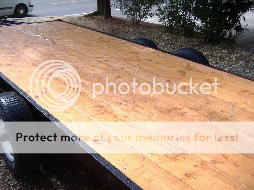

I got the deck done today :thumbsup: here are pics
Re: Ol' Rusty Hauler (11th Jun 09 at 5:14am UTC)
looks like new! :thumbsup:

sealer works good :thumbsup:
Re: Ol' Rusty Hauler (13th Jun 09 at 6:39pm UTC)
I need to do that to my trailer. What brand sealer is that? Do you spray it on?
Re: Ol' Rusty Hauler (13th Jun 09 at 11:27pm UTC)
Olympic from Lowes PPG makes it, The old man at the trailer supply recommended it, Rob put boiled lin seed oil on his I like the way his turned out too.... I used a foam roller and just rolled it on did all sides before putting the deck on, I got a cedar tone sealer it comes in that clear or redwood color
