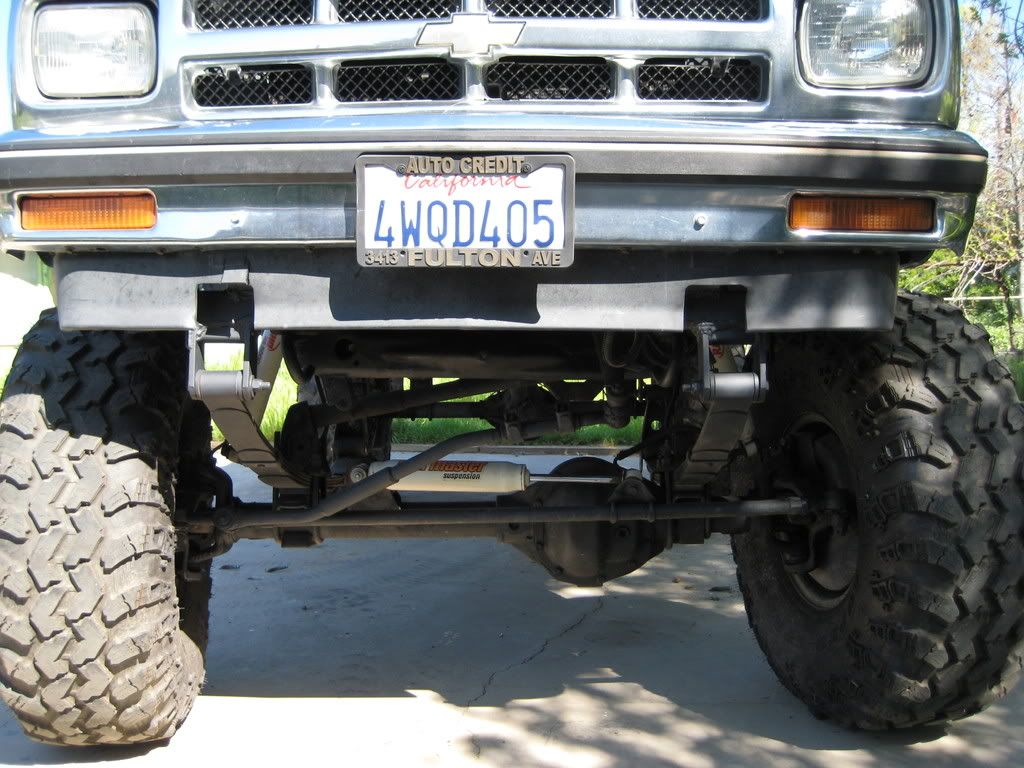

| | Re: SAS for a 88GMC S15 Jimmy (26th Mar 08 at 8:14pm UTC) | | well it depends on how much wheelin your really gonna do , and also what size tires you wana run ? and are you really gonna be happy with that size tire , or you might wanna upgrade later ? here is my budy robs , that i kinda helped with . with a 44 in the front , alitle to high but on 37's
 with the panhard bar it drives tits | |

| | Re: SAS for a 88GMC S15 Jimmy (26th Mar 08 at 8:51pm UTC) | | i wanna be able to do all the runs and shit, i dont think i wanna go bigger than 35's, maybe a bit smaller than your boys rig, but thats the idea, as long as i can get to winch hill 3 to watch you blow out a drive shaft i will be happy, haha, but that rig looks sick, its most likely going to be my daily driver for a while longer. | |

| | Re: SAS for a 88GMC S15 Jimmy (26th Mar 08 at 8:52pm UTC) | | | hey is his front drive shaft attached, i think i want to be able to turn all fours haha | |

| | Re: SAS for a 88GMC S15 Jimmy (26th Mar 08 at 10:04pm UTC) | | hey is his front drive shaft attached, i think i want to be able to turn all fours haha ya not quite done yet that is one of the problems , why i said too tall , he eather needs the tom woods offset u joints or lower it down alittle prety sure its gona get both | |

| | Re: SAS for a 88GMC S15 Jimmy (28th Mar 08 at 1:34am UTC) | | | hengl, were you there during the mounting of the springs, did they run a cross member arcoss the front frame to attach the shackles it looks likey might have. you have any pics of the front under. Graci graci. | |

| | Re: SAS for a 88GMC S15 Jimmy (28th Mar 08 at 3:42pm UTC) | | | no the shackles are mounted rite off the bottom of the frame | |

| | Re: SAS for a 88GMC S15 Jimmy (28th Mar 08 at 3:49pm UTC) | | | so straight on the frame no cross member, nice | |

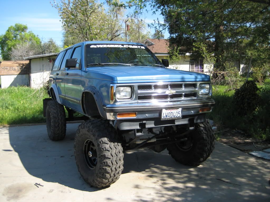

| | Re: SAS for a 88GMC S15 Jimmy (28th Mar 08 at 3:51pm UTC) | | here is about what i wanna do hengl
mine is the 2 door like this dudes, and in the other pics hes getting it, he's running 37's which i may do but probably would stick with 35s, i dont know though it looks pretty sick | |

| | Re: SAS for a 88GMC S15 Jimmy (28th Mar 08 at 3:59pm UTC) | | ya it looks cool , kind like a 4 runner i think the 2 door one is linked front and rear with some SWLs in the front and LSB in the back | |
