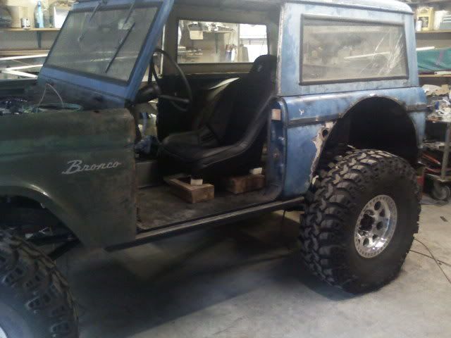

| | Re: shat (4th Jun 08 at 2:38am UTC) | | cant drive and do video too. no free hands, and i adjuted the intermediate band and now i have forward and reverse. sic. so now the tops back on and im off to work on the cage. damn im glad. still have a ton of body stuff to work out but that will be after it gets prettymuch done.  measureing for the cage.

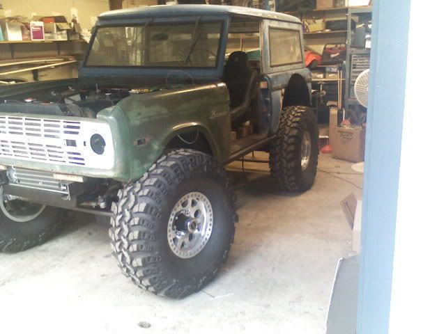

| | Re: shat (4th Jun 08 at 4:53am UTC) | | holy big wheel well batman . damn you and your RG beadlocks :thumbsup: | |
BigToy Zombie Member
![[Avatar]](http://www.rockzombies4x4.com/jason1.jpg) Posts: 444 Status: Offline Gender: Male Location: Diamond Springs Joined:
| | Re: shat (4th Jun 08 at 4:57am UTC) | | | thems kmc son the RG's went back, casting flaws arent fun. | |
TROUT Vendor
![[Avatar]](http://i127.photobucket.com/albums/p128/DOWNHILLIN_DAN/Jeffmcafee.jpg) I see U run, I still stab you face! Posts: 865 Status: Offline Gender: Male Location: Fair Oaks,Ca. Joined:
| | Re: shat (4th Jun 08 at 5:05am UTC) | | AW FAWK!! those are still bad ass. those look like the corr wheels. I love Corr ff topic: | |
