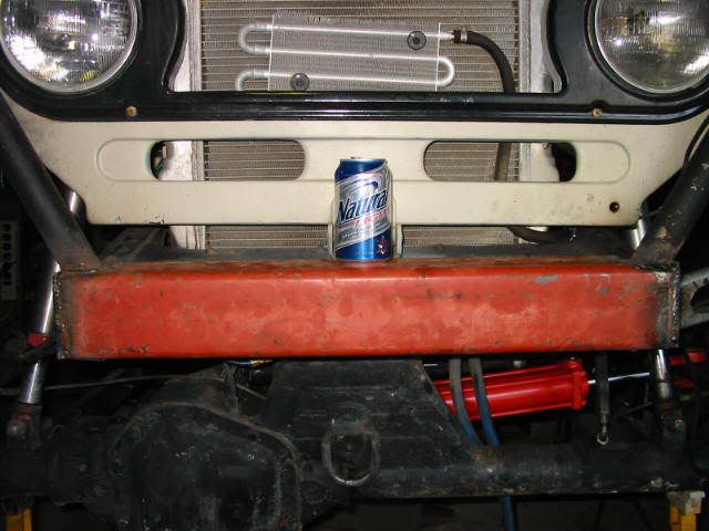

plan is to mount ram behind axel to the tie rod , pretty much as it is now but wth new mounts. orbital ill be on frame next to the pump.

parts collected, :boobs:
bumper done
yeh weld.
orbital should be mounted tonight. :booze:

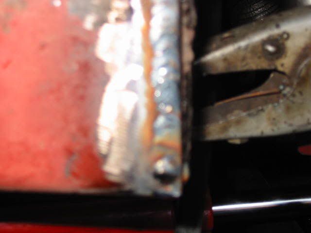

today was slow, welded the mount and hookd up the shaft. did some grinding

well im at a stand still. need to commit to a ram plan.
10 in ram needs to be 8in.
do i?
-drink more
-buy 8in ram = 90$ (no)
-run a 2 in spacer on the outside
-run a 2 in spacer on the inside
-run a 1 in spacer on the outside and a 1in on the inside
-have 2 in cut off the shaft and re thred it.
where can 1 get spacers for a 1 1/8 shaft?

lookup hydro steering on the pirate board I know theres stuff in the toyota FAQ on it but there are a few write ups on stops for your ram, most run a little bit bigger ram than needed with stops, some just clamp around the shaft, theres a few different ideas on there
