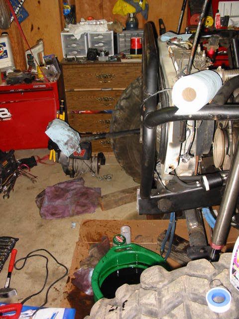

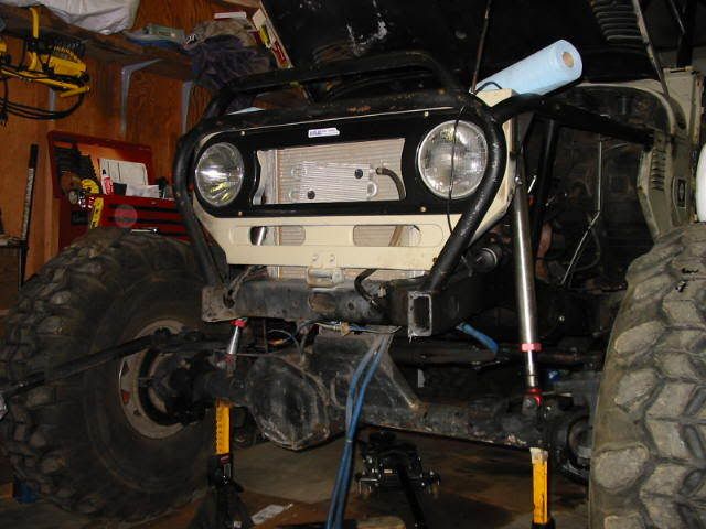

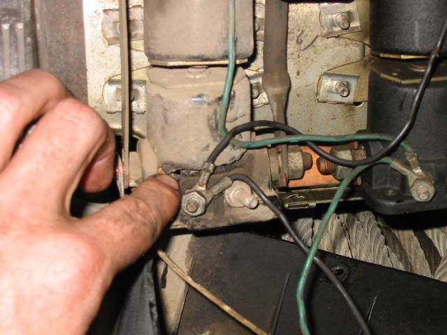

Re: cheap full hydro steering - Posted By jiMMythejerk (jimmythejerk) on 8th Mar 09 at 7:34pm
What a day. got the cruiser outside and cleand up. drove it around for 20min. all was well till i noticd my PS leak progressd to a stream. ugg. back in the garage, pulld the box to snugg up the fittings and a nice crack in the front cap. sure i could fix it or even get the billet cap ( would have to notch more bumper) and still have the same steering. said fawk it and pulld it all off. going to fix the box later and trasfer the set up to the lil jeep.
hmm no wonder my winch suckd at times.
bye bye winch
bye bye bumper
new approach
time to collect some parts.... :thumbsup:

Re: cheap full hydro steering - Posted By jiMMythejerk (jimmythejerk) on 9th Mar 09 at 8:16pm
yes im keepn the winch 4 now.
bumper 90% done, ran out of wire and beer, {Sad}
what mite you have that i need?
i need -
1 inch plate
hose + fittings
plan is to mount ram behind axel to the tie rod , pretty much as it is now but wth new mounts. orbital ill be on frame next to the pump.
