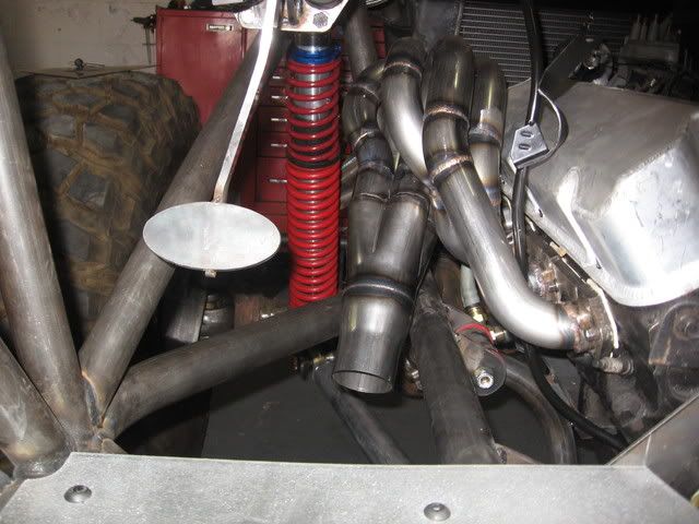

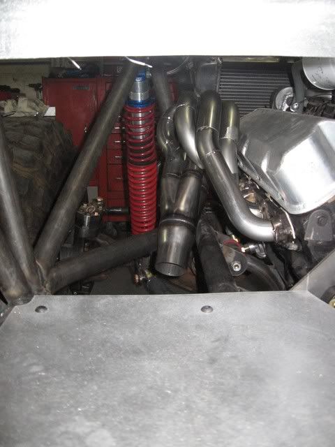

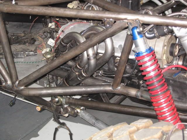

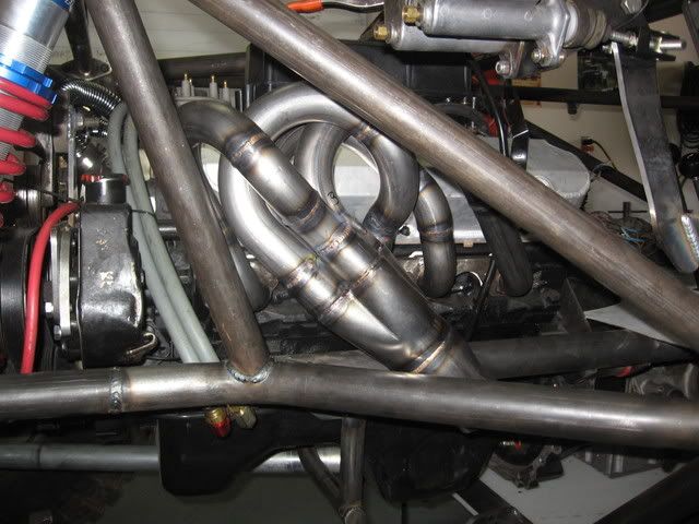

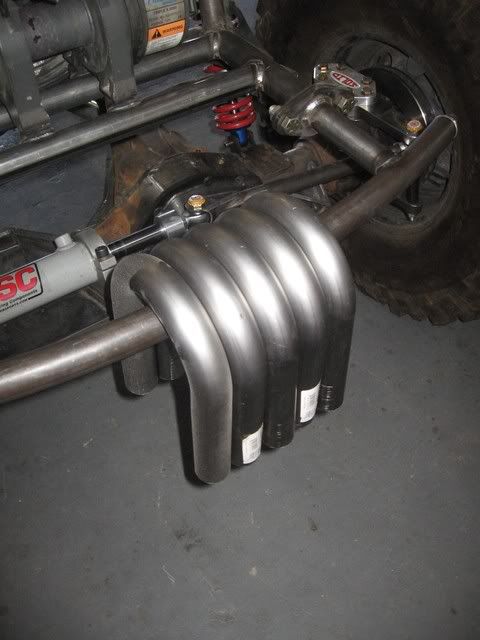

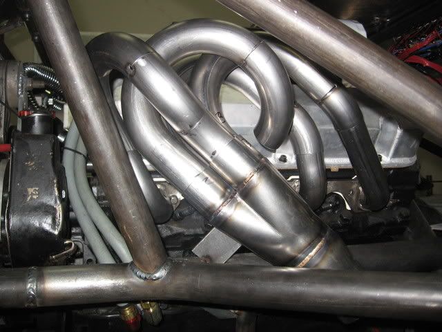

| | Re: T-CARPS Buggy build thread! (18th Aug 08 at 2:59am UTC) | | started with
then
Pass. side
driver side
TROUT Vendor
![[Avatar]](http://i127.photobucket.com/albums/p128/DOWNHILLIN_DAN/Jeffmcafee.jpg) I see U run, I still stab you face! Posts: 865 Status: Offline Gender: Male Location: Fair Oaks,Ca. Joined:

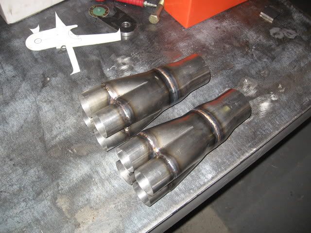

| | Re: T-CARPS Buggy build thread! (18th Aug 08 at 3:05am UTC) | | welded up. They are all within an 1" of each other

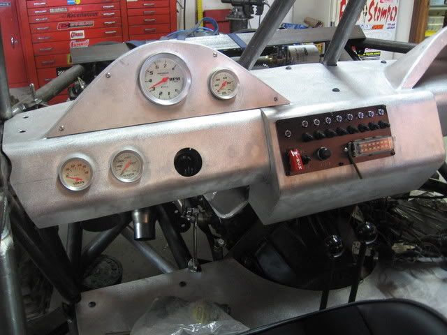

some gauges and switches

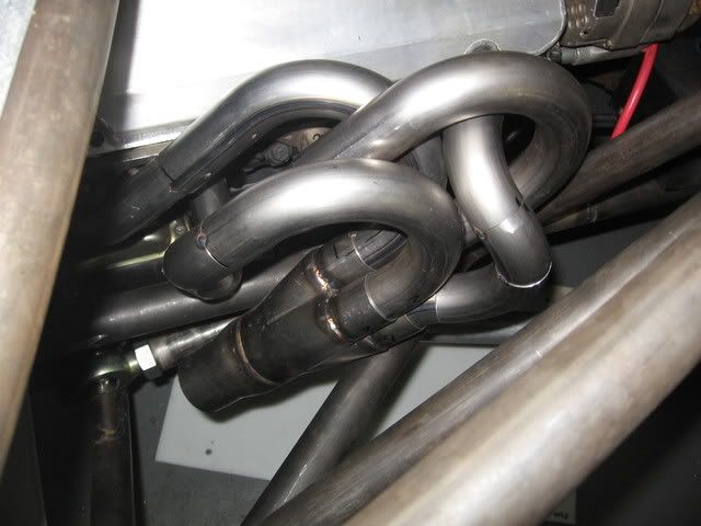

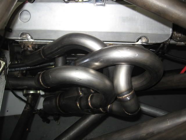

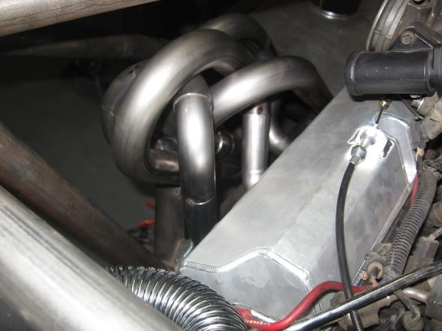

| | Re: T-CARPS Buggy build thread! (18th Aug 08 at 4:48am UTC) | | | |
| | Re: T-CARPS Buggy build thread! (18th Aug 08 at 4:50am UTC) | | | Will you be able to get the valve covers off without the header having to be removed? Looks close but its probably just the pic, I'm sure you didn't have alot of room to work with. Awesome job Dan!!!! | |
TROUT Vendor
| | Re: T-CARPS Buggy build thread! (18th Aug 08 at 2:42pm UTC) | | | no you cant. you must sacrafice things to have some other things the way you want. there is not very much room. the driver side is kicked farther forward to keep away from the pedals. there are lots of things that have to come out to get to others. thats the way small buggies are. | |
| | Re: T-CARPS Buggy build thread! (18th Aug 08 at 10:53pm UTC) | | | Fair enough, awesome none the less!! | |
| | Re: T-CARPS Buggy build thread! (18th Aug 08 at 10:54pm UTC) | | PS. T-Carp, adjust those valves before the final install!! | |
| | Re: T-CARPS Buggy build thread! (19th Aug 08 at 3:44am UTC) | | Already done, remember I went thru the motor and put a new cam and stuff in | |
