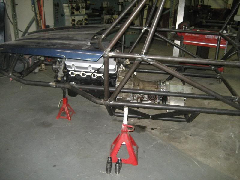

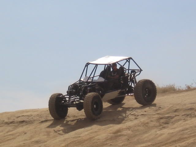

t-carps gangster lean
full comp
fitting the shock towers
drivetrain
full droop

Re: T-CARPS Buggy build thread! - Posted By TROUT (fishmouthfabworks) on 19th Jun 08 at 8:39pm
some i forgot to add the other day...

Re: T-CARPS Buggy build thread! - Posted By TROUT (fishmouthfabworks) on 24th Jun 08 at 11:27pm
start of the floor.needs a little bit more tuning.Image

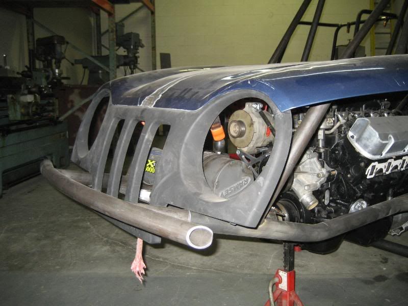

Re: T-CARPS Buggy build thread! - Posted By T-CARP (admin) on 14th Sep 08 at 5:24pm
Love the pic with the hood and grill {Grin}

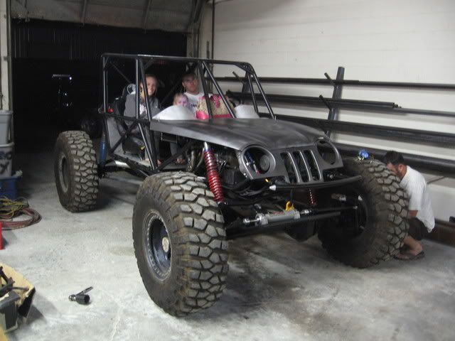

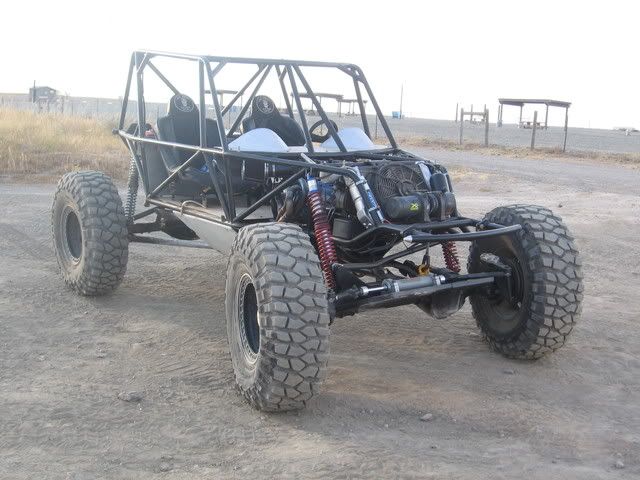

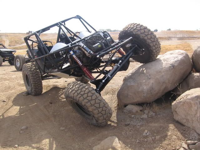

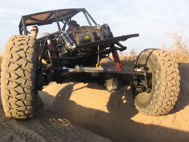

How many degrees do you have the front coilovers racked back?
Re: T-CARPS Buggy build thread! - Posted By kranker (kranker) on 15th Sep 08 at 10:40am
Nice!
Why does Goodby look pissed?
because t-craps is done and his is not {Grin}
Re: T-CARPS Buggy build thread! - Posted By TROUT (fishmouthfabworks) on 15th Sep 08 at 8:30pm
around 20
Re: T-CARPS Buggy build thread! - Posted By Alotakids! (alotakids) on 16th Sep 08 at 1:06am
around 20
Are you running offset spacers inbetween the coilover tabs and the coilovers? I only ask because my front coils were setup very similar and the front wheel under full compression and heavily loaded up would break coilover shafts in half from binding in the tabs. Just trying to mabey save you some $.
Re: T-CARPS Buggy build thread! - Posted By TROUT (fishmouthfabworks) on 16th Sep 08 at 7:42am
there is no binding. the tabs are 90 of each other. they cancel eachother out.
