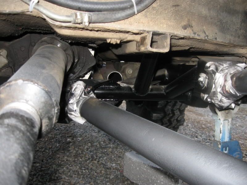

The trailer should be a little happier now that im not over teh axel limit...hahaha
Rig did great 4 link was awsome! Just nosiy. I think we narrowed it down the the new hiem joints being the culprit! Hopefully i can work something out with where i bought them.
I did however find out what my weak link is in the rear!
32spline output and CV went bang

Well saturday it when i broke the rear CV the shock load must have been termendous on that output and probably twisted it then, or definately weakend it.
The backdoor just put it to rest.hahha
And like Baggy said Jose probably had been beating on it mowing lawns 20 yrs prior to me getting it...lol
Will see what happens ill throw a new one in, get rid of the CV and run a 1410

Well messed with the coilovers and Swaped some springs around and it definately is much better and i only drove like 50ft.
Got rid of the CV and replace it will a new 1410 yoke as well as replace the 32 spline output. Clears the crossmember just bearly.
Took some quick measurements. From the ground to the top of the cage.(With 47") 6psi 77.5" Smiley Cant wait to go to the rubicon and run the same lines that used to get that pucker feeling going. Hopefully it will be night vs day.
From the ground to bottom of the rocker
27.5".
For u guys running jeeps with 35" or around there, what the measurement from ground to rocker on urs?
