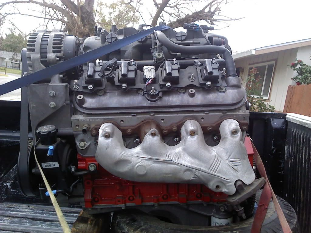

| | Re: No Limit Chassis build for BigRob (16th Mar 11 at 5:45am UTC) | | So tonight i drove all over to get a pencil camera and check the pistons via spark plug hole and it turns out i have an LQ4 not an LQ9 so i check the other motor offered to me as well it is an LQ4 so no biggie i am still excited. Then i received the computer for said motor and it has the vehicle info on it and turns out its from a 2005 Denali.. thats cool only 62,000 miles on it.

| | Re: No Limit Chassis build for BigRob (16th Mar 11 at 3:34pm UTC) | | | No big deal about the Motor its the same as the LQ9 just has a little bit lower compression of 9.4:1 rather than the10:1 of the LQ9. Being that your motor is a 05 you have aluminum heads, the 99-00 LQ4's had cast iron. Maybe goodby will give you a good deal on his blower, lol. | |

| | Re: No Limit Chassis build for BigRob (17th Mar 11 at 3:10am UTC) | | Hogan i am reading an engine builders book for these Gen III motors and they list the ls6 and lq9/lq4 heads as the heads to run. it says the lq heads where derived from the ls6 heads with the same port size but 8 cc bigger chambers so they are ideal for boosted engines and the ls6 for naturally aspirated engines. useless knowledge i know...... i thought i would tell you it also says that the early cast iron heads from these motors are less than desirable...lol | |
