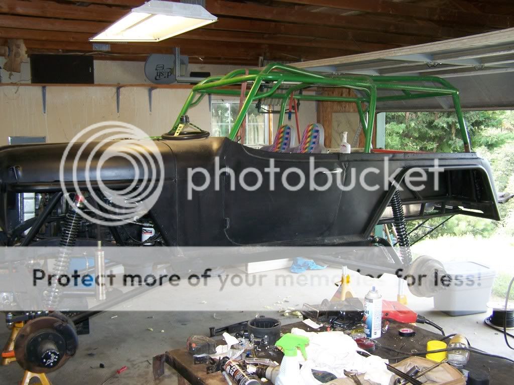

| 69 soncho (18th May 10 at 3:13am UTC) jeepster | | hear it is

| | Re: 69 soncho (18th May 10 at 2:46pm UTC) | | | Lol i figured. So whats the specs motor trans wheel base tire size ? I like it. | |

| | Re: 69 soncho (19th May 10 at 12:12am UTC) | | well its a 69 tbi 355 700r4 3.8 atlas 60/det/5;89-60/spool with all chromo shafts 3 link panhard front 4 link rear 16" coilovers 15"allied beadlocks and 42"tsls | |

| | Re: 69 soncho (19th May 10 at 12:14am UTC) | | | ohh it has a cj-7 hood and a 122" wheelbase | |

| | Re: 69 soncho (19th May 10 at 3:53am UTC) | | Very nice....
What are you doing with it? | |

| | Re: 69 soncho (20th May 10 at 12:04am UTC) | | | still got alittel of work left ill be done at the end of june ive drivin on enough winchs is my life | |
