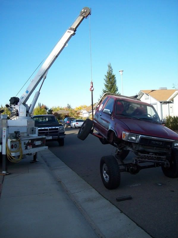

A couple pics of the yota (14th Nov 08 at 10:02pm UTC)

Re: A couple pics of the yota (15th Nov 08 at 1:35am UTC)
Looks good. Why dont you post up some info. Thats what a build up is all about. Whats the frame height under the doors? That thing looks big.
Re: A couple pics of the yota (15th Nov 08 at 1:53am UTC)
29" From the ground to the bottom of the frame. Its got a 44 in the front with an A.R.B homes brewed leaf packs its stretched 8 inches in the front and i moved the rear foward 11 inches the over all wheel base is 122 wich is more than i wanted but it should work. In the back is a dana 60 4 link fox shocks and soon to be welded im runing 5.89 gears and jp eater duals with a 4 to 1 in the rear case the witdth from out side of tire to out side of tire i guestimate will be 90inches wide give or take a few

How did you move your axle forward 8 inches? Did you measure that with the spring flat or just the way it sits. Are you using Toyota rear mains? So is this a trailer queen?
And how do you have more reputation than me{Confused} You dont even wheel
Re: A couple pics of the yota (15th Nov 08 at 10:14am UTC)
The cross member was moved forward 3.5 to 4 inches and i estimate the the springs at ride hight are about 3 and a half give or take an inch. Its pushed foward a ways. No its not going to be a trailer queen it wont be totaly legal either. I am going to trailer it to the trail but i would like to drive it around town also. I have changed the leaf pack since i took those pictures. I am running toyota mains with some other helpers. I t should be done by january. And if you look real hard i have minus two reputation points so dont trip you are cooler than me lol
Re: A couple pics of the yota (15th Nov 08 at 3:11pm UTC)
You had better get some more attachment points in the rear of that thing or it just might break in half when least expected.... {Grin}

Re: A couple pics of the yota (15th Nov 08 at 5:53pm UTC)
It will tie into the frame in two other spots and also it will tie into my exo and rock sliders. I just wanted to cycle the suspension a.s.a.p to see if anyting was binding.

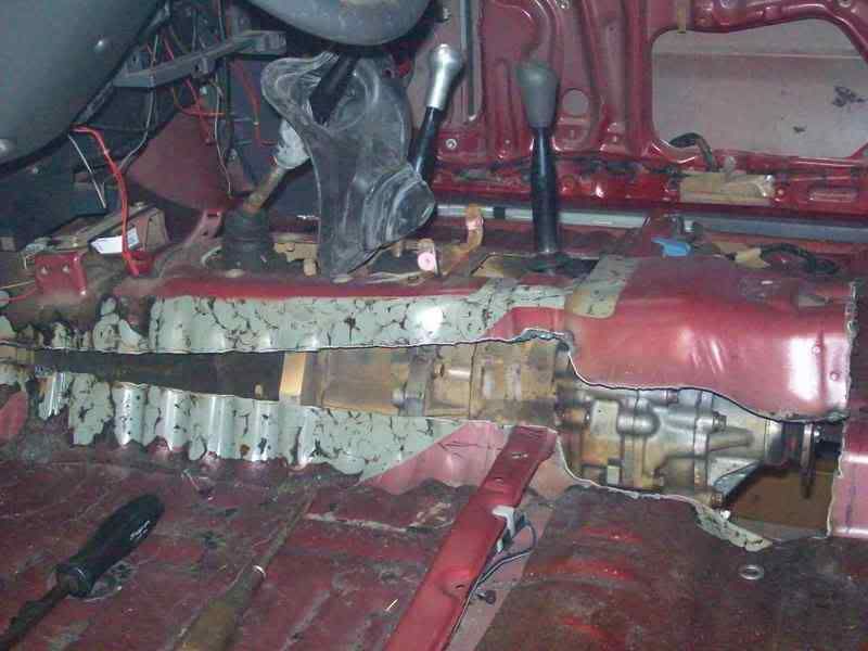

Re: A couple pics of the yota (20th Nov 08 at 3:22am UTC)
hers is the pick from the flat bell i started this weekend

Re: A couple pics of the yota (20th Nov 08 at 6:23am UTC)
Nice start. What are you using to make it strong? 3/8 plate? did you raise the motor to match?
