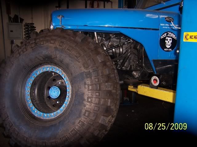

Looks like I am getting a pretty good look. I am leaning on the front tire..... {Tongue Out}

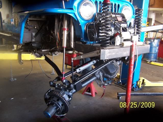

Here is what is going in it. CNC ported, stainless 2.02 1.57 valves, PRC double springs, Titanium retainers, milled a touch, 228/234 .588"/.598", LS6 intake, no O2's, no cats, crappy set of blockhuggersImage
Re: Not exactly a full build...but holy crap tha.. - Posted By Keith (psmurfbeotches) on 26th Feb 08 at 8:52pm
Lowers are 2.5" .375", upper is 1.75" .250". Joints are 1 1/4".
Housing is a Currie Rock Jock, 5.38's and loaded with ARB. Ofcourse it will run the Superior shafts and CTM's. Knuckles are the welded steel ones Tony used to sell. C/O's are Sway Away's 2.0" 14" travel. I already have the fresh wide ratio NV4500 and Atlas 6.0. 1350 joints all the way around. I will be bringing it to ForceFed in Roseville pretty sure, to have the engine dyno tuned. I dont know about in the jeep, but in an Fbody, it should lay down something just over 400rwhp. Look the fuck out. I have PSC steering goodies to go on it, and have the wheelbase at 101.5" now. After I get to drive it this summer (god willing), it will get a cell and 4link in the ass. Put some bars around your rigs boys, I am comming to play!!!!!!!!!!

Re: Not exactly a full build...but holy crap tha.. - Posted By EdoublE (edouble) on 12th Mar 08 at 4:57pm
who makes the truss and cover that 4 kink is attached to{Confused} Looks pretty dam stout.
Re: Not exactly a full build...but holy crap tha.. - Posted By Keith (psmurfbeotches) on 12th Mar 08 at 6:36pm
That truss is from Currie. I put the link mount on top and the bump stop. The cover is just a thick D60 stock cover. BTW, that is a three link {Unsure}

Re: Not exactly a full build...but holy crap tha.. - Posted By Keith (psmurfbeotches) on 16th Mar 08 at 8:25pm
Got it on the ground. The coil rates are not right just yet. Top coil is just about bound before the lower starts to work

looks like you have the new disappearing axle shafts and joints..... {Grin} can't you shorten your swaybar links any?...sheesh {Rolleyes}
Re: Not exactly a full build...but holy crap tha.. - Posted By Keith (psmurfbeotches) on 17th Mar 08 at 7:52am
Posted By FishmouthFabworks on 16th Mar 08 at 9:02pm
not bad for an old guyImage
Thank you Sir...
Can't shorten them Rob. When it droops, the link will start to point straight at the axle. That seems to be the length it needs to stay out of the side of the grill at compression, but still have a decent angle so it will work at droop. Once I get the limit straps on, I will run through the setup again.

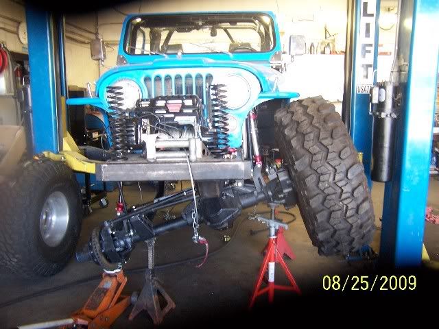

Ok Kranker, here is a pic of the cover :beer:
The front is done. Working on getting the rear c/o's to clear, then on to the fuel tank

I am pissed. I cant get the clearance I need to clear the tire rub on the coil with those damn WE wheels. My MRT's with the two in BS should work ok. If I did not have those Superiors in the front, I would have made it full witdth Smiley
Re: Not exactly a full build...but holy crap tha.. - Posted By TROUT (fishmouthfabworks) on 14th Sep 08 at 4:45pm
should of leaned them back.
Re: Not exactly a full build...but holy crap tha.. - Posted By Keith (psmurfbeotches) on 14th Sep 08 at 5:40pm
It has enough drop. At least I think that is what you mean. Any more than it has now, and it steers a alot. Also, being the fag that I am, I wanted to keep the rear seat and storage. Moving them to the rear meant I would loose the seat.
Re: Not exactly a full build...but holy crap tha.. - Posted By TROUT (fishmouthfabworks) on 14th Sep 08 at 5:49pm
lean them toward the back of the tub. in side the wheel well. they should fit. done a few tjs that way.
Re: Not exactly a full build...but holy crap tha.. - Posted By Keith (psmurfbeotches) on 14th Sep 08 at 5:53pm

where the hell is the cell going? is you rear seat all the way back?
Re: Not exactly a full build...but holy crap tha.. - Posted By Keith (psmurfbeotches) on 14th Sep 08 at 6:11pm
Back as far as it can go. The cell is going underneath, stock spot, just a small 15 gallon one. You should know, you are building it.
