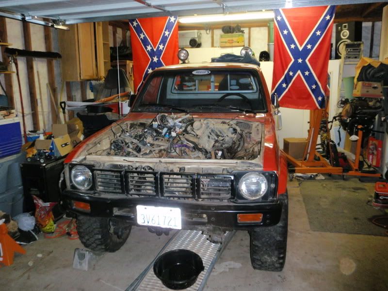

Re: General Lee Build up! NEW PIX!!!!!!!!! - Posted By The General (highlakeswheeler) on 30th May 08 at 12:01am
hey everyone sorry i finally just got moved in to my new house! i was working on my truck before i even unpacked! LOL! but here is some pix of what has been going on the last few days.

Re: General Lee Build up! NEW PIX!!!!!!!!! - Posted By yeagley (yeagley) on 31st May 08 at 9:28am
Thats one dirty bitch right there. Are you still doing EFI? Are you using that motor in the picture?
Re: General Lee Build up! NEW PIX!!!!!!!!! - Posted By The General (highlakeswheeler) on 31st May 08 at 6:23pm
no the motor in that pic is the old motor. the pic with all the wireing on it is the new motor. yea the old motor had a few..........ok a hell of a lot of leaks!!!!! she was
like almost 4 qrts a day of oil. so i thought it would be time to move up in life and get something better! LOL
all it problably needs is a few gaskets some new rings and shed problably run for another 100,000 miles! so if anyone wants a 22r let me know!
P.S. dose anyone know about the smog rules about motor swaps because i have been told a lot of diferent thing and i dont know who to trust! LOL!
so pleas throw me some INFO! thanks!!!!!!! :kranker: :kranker: :kranker:
